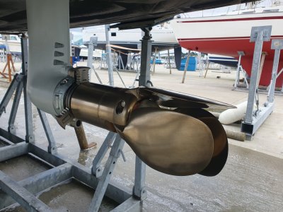

My Flexofold 3 blade with Hydroaxe rope cutter just fitted.
