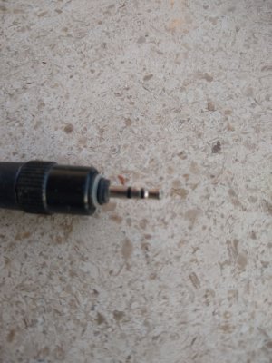

My Entel radios have what looks like the same connector for the handsets. Maybe you can get one from them.
I just checked dia. with caliper and definitely 2.5mm as you suspected.
Entel pic below.

Cobra Marine Radio To Headset Coil Cord Cable
Think this connector is what you need but probably not from this place at that price.
Entel pic below.
Ah - getting closer to home now and much cheaper. https://www.amazon.es/-/pt/dp/B073H...cphy=1011728&hvtargid=pla-1882207454624&psc=1
Jack Plugs | Jack Sockets | Jack Connectors | RS RS catalogue.
A possible problem with these is that the socket on the Cobra is designed for a threaded collar above the contacts which would restrict the access of jacks with a larger diameter than the thread. Another point to confirm is whether the jack on a cobra is 3 or 4 sections. mine for Yaesu are 4 as the same port is used for programming channels .
