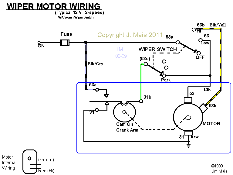

This is a typical circuit for a self parking wiper motor.
Where you have 3 driven from the same switch you need a separate contact in the high and low power supply to each motor otherwise you will get power feed from one motor park contact to another as pvb said.
A way to solve this is to have a relay between the operation switch and each motor with a seperate relay contact for each motor

This is another way that self parking wipers are wired.
This shows a 2 pole 3 position switch and if I remember correctly the vetus switch is single pole 3 position.
