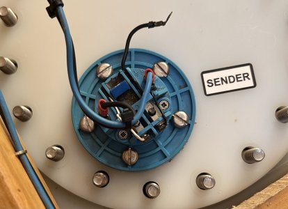

I have a VDO water level sender on one of my two water tanks that gives no reading at the gauge (the gauge doesn’t move at all) , but the gauge is ok (tested on the other tanks connections) I have 12.9v on the terminals at the sender. I have removed the sender - is there a way to test it or perhaps service it. It has no moving parts. A replacement is silly money ! Has anyone had similar issues or a solution? Thanks.

Isn’t there a movingbit below?
Senders change resistance so get a multimeter on it and measure while changing the level (maybe fill the tank then pull the sender up and down).
0-180ohm usually

The VDO sender unit you currrently have is a 4-40ma sender.

Great info- Thankyou.
