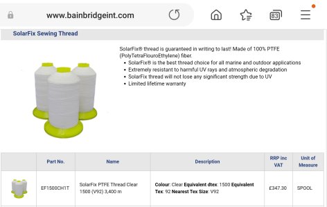

To be honest. Steer clear of the Solarfix PTFE unless your are seriously good at setting tensions on a sewing machine.

Gutermann do a specialist product - Solbond, (not used it myself) which may be the one you heard about? Bad news is that you have to buy 3000 metres, better news is that it will cost c £40 delivered
They also do Coates Dabond, (which I do use and like) a little cheaper.
