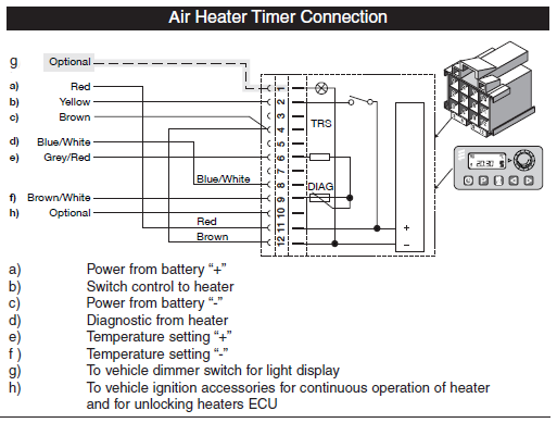

There's a very similar looking one on this page, complete with pinout diagram: Controllers 2
Same buttons, just display and dial are swapped. Seems to be custom ones for some car/truck manufacturers.
Thanks for the try but I have the type you show, its the wiring for the one I show that I am having problems with. The pins the red/slate and brown/white were easy as the resistance across them changes as you adjust the heat setting knob. I believe I also have the red and yellow but am less certain about the blue/white diagnostic lead. Dont want to resort to trial and error!!
