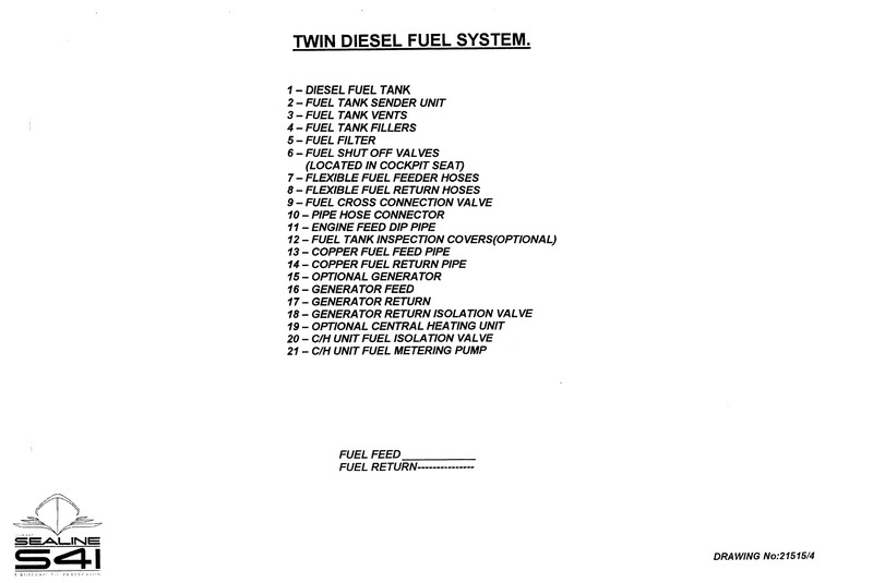

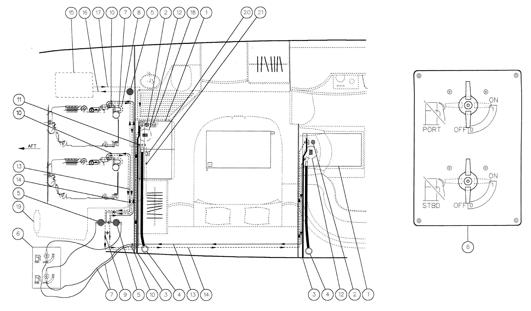

You have it a little bit wrong return lines should not have isolating valves. Look at Flower Power's drawing of the fuel system and what you see is FEED isolating valves there are no other valves in the system. Stop the engine you stop the flow much safer. Jim
I’m not sure that’s correct.
Item 9 on the diagram looks like the return crossover / isolation (the dotted lines are the return path).
Item 5 is the feed isolation and crossover.
I have similar sets of valves on my SC35.
Hi item 5 looks to me like fuel filters for the main engines and item 9 looks like a 3 way v/v with position # being return open to both tanks / position # return open to port or stbd tank/ position # return open to port or stbd tank depending on how the tanks are piped up but will not act as an isolating v/v as one way will always be open, and it looks to me as if both return lines have been drawn to pass the under the fuel filters. If you look at the top of the drawing there is what looks like a gen set (item 15) which also has an item 5 (fuel filter) but as far as I can see there are no isolating v/v's of any type in the gen set fuel system. The drawing is badly drawn as if I am right and item 15 is a gen set then it has 2 broken lines(returns) going to the gen set but no fuel feed. Jim

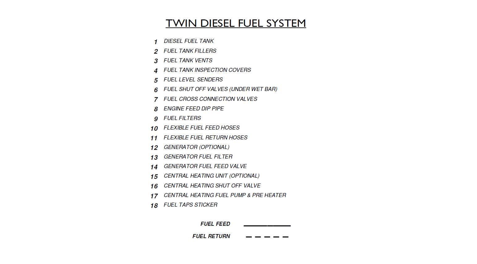

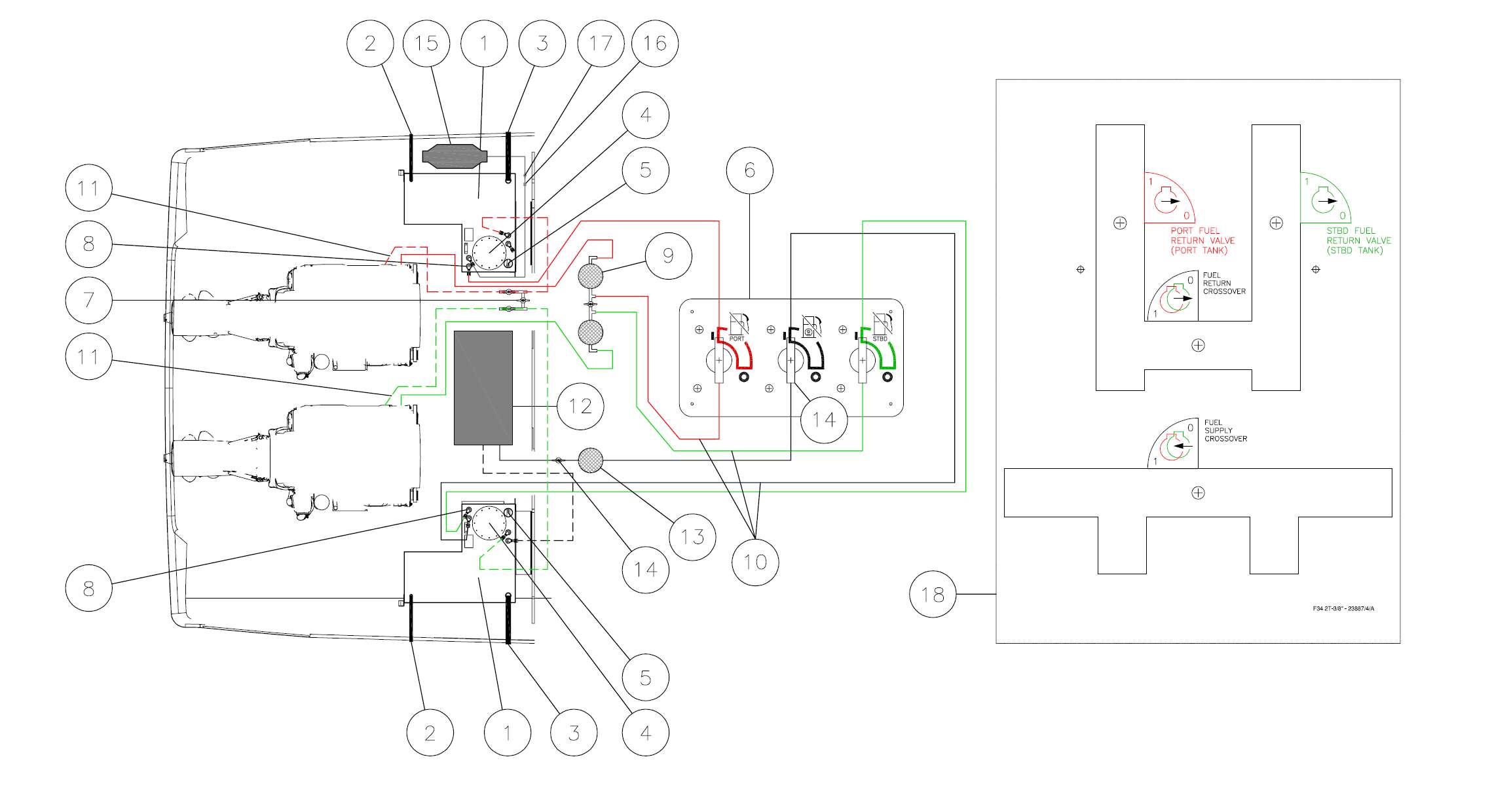

I should probably have posted the "key" to the diagram as well.
15 is indeed the gen set ... the dotted lines to it are because it's optional.
The other dotted lines are the return lines.
Hi so are we agreed that there is no need for fuel return shut off v/v's in the system just changeover vv's. Jim
I’ve managed to confuse myself.
Looking at the SC35 diagram, there are shutoff valves for the return lines, item 7. And they do exist on my SC35.
But closing either of them with a running engine would be disastrous unless that valve in the diagram is actually the other way around.
I’ll take a closer look at the actual layout at the weekend.
Hi me again, I must agree in your drawing there are fuel return shut off v/v's in each of the return lines. The v/v's are set right for normal running. If you look at the legend item 7 is described as fuel (return?)cross connection valves(misprint ?) but no mention of shut off v/v's. Jim

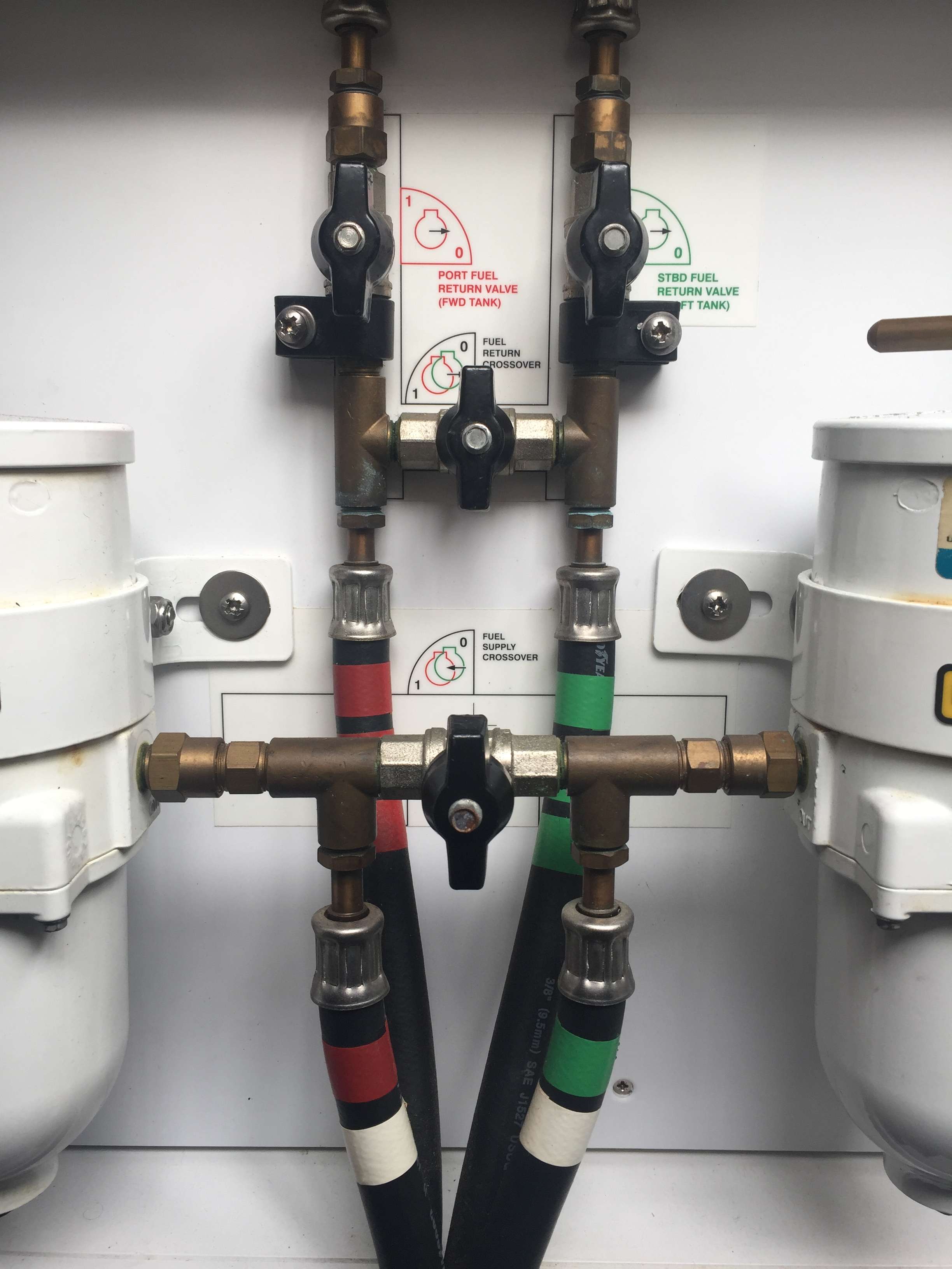

So this is what's on the bulkhead.
The fuel supply shutoff valves are elsewhere in the cockpit.
The original poster will have something similar.
