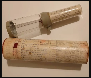

Ventimeter
Doesn't interface with anything but if looked after will last forever
You always find them on ebay... I got one in as new condition

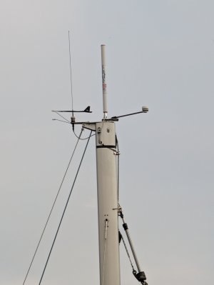

We've also got a CV7, and it lasted 10 years before going out of calibration. Capteurs were most helpful, and we went through several cycles of data logging and firmware uprades before we gave up; they then sold me a discount replacement.
Changing the instrument was a pita; swinging around at the top of the mast trying to solder tiny wires... Anyway, I would buy another one rather than a whirylgig thingummy, as the starlings are very agressive round our way.
