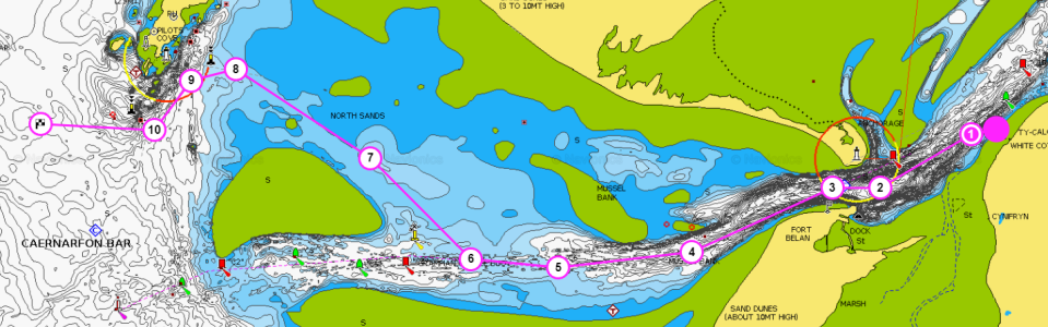

I will plot a route and share a screenshot - would you mind casting an eye over it to make sure I have got it right?
Hope that's clear enough!
I'm sure Chris (at Ty Calch) will be able to point us in the right direction, but good to get other opinions.
Our situation is that we will be launching there while we're staying in the area over the summer. The Mrs isn't happy that we can "officially" only launch at HW +/- 3hrs as it really restricts us, to the point where she's in a "we might as well sell the boat" frame of mind!! Aaargh!!
As I see it, with a 0.85m draft, so say 1m to be safe, and assuming no more than a 1 - 1.5m swell (to avoid bouncing off the bottom!), we could be ok with this route. Obviously I'm conscious of the wind forecast too. Even with 220hp, it's not a pleasant experience being thrown around!
Really, all I'm looking for is guidance/advice as to whether we can get from Ty Calch, over to Pilots Cove, then either up the Anglesey coast to Holy Island, or down the Llyn to, say Porth Dinllaen. And of course, having enough water under us to get back safely to Ty Calch!!
Really appreciate your help - thank you :)

Yes, we had a 8m Fairline in the area for three seasons.
What you will find is the timings over the bar most likely wont be your limiting factor, the weather / wind / tide combination will.
With your draft, you will be able to easily push that 3hr window, and with experience judge it better each time.
With any sort of wind over tide you may find yourself not making too many friends amongst your crew, its a small boat after all. The bar can be pretty unforgiving and it can be for some distance.
Not sure of your experience but get confidence in your boat, launch, recovery etc prior to going on adventures, particulary with new comers to the game aboard. Turn right and use the straits, plenty of day out opportunities to cut your teeth. Find your and your boats limits in relative safety.
The Ty Coch is a long way and can be exposed. As is Holy Island, or maybe even more so. For these trips, you are looking at perfect weather conditions in your boat, particulary loaded up. Don't underestimate them.
When the conditions are right, the area is absolutely fantastic. When they aren't, its absolutely horrendous in a small boat.
We have plenty of videos of our trips out in this area. Check them out to give you a feel.
I crossed at pretty much bang on low water on Sunday June 11 so neapish and briefly touched bottom between C2 and C3 drawing 1.8m . There was plenty of water everywhere else. You could cross anytime you like except near LWS.
We also touched near C10 an hour later (if you were to turn right after launching).
