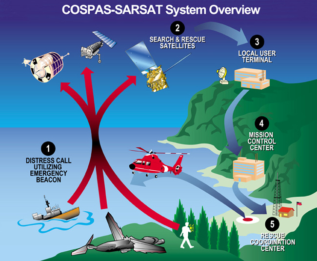

EPIRB is what get's you found, even if none of the above succeded. It is a one way transmitter, so you cannot use it for speak/communication.
I get the thing about using same device in more boats, but as mounting height/length of antenna and transmitting power decide your ability to get in contact, small radios held at or below surface really are limited in range.
The EPRIB does not transmit to land or other vessels and will do it's job anywhere (also in the outback or mountain trekking). It delivers data for SAR:

In practice DSC is a little better than voice over VHF because it's a digital "squirt". There's some clever software that means that quite a bit of the signal can be missing but the receiver can still work out what it should be. Also digital has an advantage as the receiver only has to decide black or white instead of trying to reproduce shades of grey (not the book). That means your DSC signal may be received and translated even though there's no voice comms available. It's not a huge difference though - 50% increase in range at best I'd say and sometimes a lot less. The thing to remember with EPIRB's and PLB's is that there is a delay while the Coastguard go through the process of checking, etc. With a PLB or EPIRB you've got the nearest you'll get to a 100% chance of being found and rescued but it's going to be an hour in the water probably - with a DSC message a passing boat will be able to pick you up possibly within a few minutes in that area.
