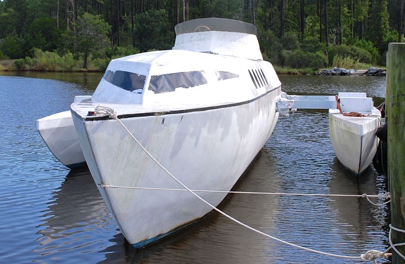

twin 6hp engines - 50 footer - simply awful boat

this one is a real dogs dinner

Audacity is a waste of good wood, good engines, dock space

looks a bit like the tri that Lakey made; but a bit bigger.
OK, there are design aspects which are a bit rough and ready, but if it works, and gives the owner pleasure - hey diddle !
Dylan missed out some of the best titbits on this wonder boat.
The hulls are made from 3mm door skins from the local diy store.
The hulls are joined, sort of, by totally inadequate cross beams. These will fail in any sort of sea. If you can find the high res pics look at the cross beam joints. Even Hotrod the constructor of the Flying Hawaiian [ still afloat ] could do better.
The outboard mounts are weak and again will fail as they get torqued off the cross beams.
There is no keel or skeg. There are no rudders.go along
Steering is accomplished by using the throttles.
The buyer has announced his intent to motor the thing to South America. The builder was offered the opportunity to go along on the delivery, he [wisely] declined.
