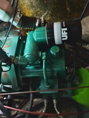

I finally managed to Identify my Hydraulic transmission system, it was made by ARS Anglian Diesel Ltd. They have a website promoting their Hydraulic systems for Industrial, Agricultural and Marine sectors. I have contacted them for information as they have nothing on their website so hopefully I will finally be able to get closer to hull speed.
I don't have much hope of a reply as the current owner was only 11yrs old when this was being produced so if there is anyone in the community with information I would be very grateful.
Finding a decent anybody nowadays is very difficult, everyone here knows someone and most don't have the knowledge to judge. I am not a Hydraulic or Electrical Engineer but I can understand and design circuits and have worked in both areas in industry. I still like to do my research before taking things apart which is why I am searching for information. The problem I have is that 28hp engine does not generate enough power at low revs to drive the propeller. The previous owner overcame this by setting the prop to 18 deg, at this angle it cannot get anywhere near hull speed. The question is whether the pump is running at too high a pressure due to a restriction or loading on the hydraulic motor. Bearing in mind that the original engine was only about 12 horsepower and has been swapped for a 28hp you can assume other people have looked at this. As a last resort I will fit a bypass to reduce the pressure so as to stop the engine stalling and allow the hp to rise thus allowing propulsion to be maintained as the hull speed increases. I do intend servicing this unit probably just oil and filter but information is always useful.
