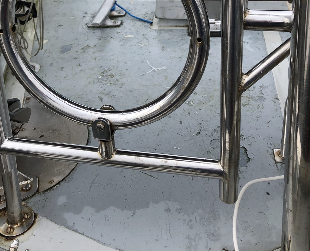

This illustrates the present state of affairs:

Something has to be Done! Next winter, not now!
Orbital sander, prime the bare patches Then Interdeck 75% Grey 25% Oxford blue gloss + non slip stuff added
contact International for colour mix % options
with the present deck paint in that condition you would need to strip it all b 4 Treadmaster application
This illustrates the present state of affairs . . .
Prepping that deck for any sort of finish involves exactly the same amount of work. There are no short cuts.
It's over the next phases that choices can be made: Initial cost, ease of application, durability, maintenance and end of life cycle renewal.
I was quite happy with International Interdek until stopped making the colour I liked (Pale Blue). Hempel suggested I use their MuliCoat with granules added but does not seem to be as durable as the Interdek.
Exactly. I can only assume that "if it doesn't move, paint it" was the guiding principle. I think it is worth taking it back to be sure that the underlying GRP is OK, and to deal with any “issues”.
