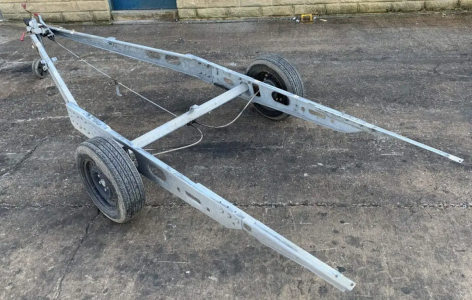

this is so. I don't expect the chassis to be rigid. I would simply U bolt a steel channel spine on it, with two post clamp bilge supports. Plus anything to make it rigid if needed.
We have found that HDPE is super slippery for dragging a boat on. A channel with HDPE lugs knocked in should be sufficient.
You will have great difficulty doing that, there is nothing down the middle to bolt your spine to. You would first have to bolt 2 or more steel box cross sections to bolt your spine to. It might still wobble like a jelly and the spine might end up rather hig off the ground.

My father built his own caravan. He built it using a new factory made caravan trailer. From what I recall the trailer was quite a flimsy affair. It derived much of its rigidity from the caravan on top of it. He also had to insert additional timber framing, within the steelwork "U" beams, to carry the floor & the longitudinal stress to the sides. The trailer manufacturer supplied this info. It was all done to make the whole structure as light as possible.
Personally I would consider a caravan trailer of similar type, totally unsuitable for anything other than its original intended purpose .
That really depends on how you modifying it...
The one I am looking at has a central spine as far as the axle and two channel frames out by the wheels, these taper to cross supports front and rear.
I need two channels to take the dolly wheels, so some more cross tubes (stiff) and weld them on after cleaning off the galv at the weld points. Since it is not going in the water, some spray galv paint on the welds will do.

For sure this, the one for sale, looks as flimsy. It will definitely need some reinforcing. But what does rule it out for me is the width: unless I needed a substantial flatbed to carry a car, it's really inconvenient. Thanks for the comments.
