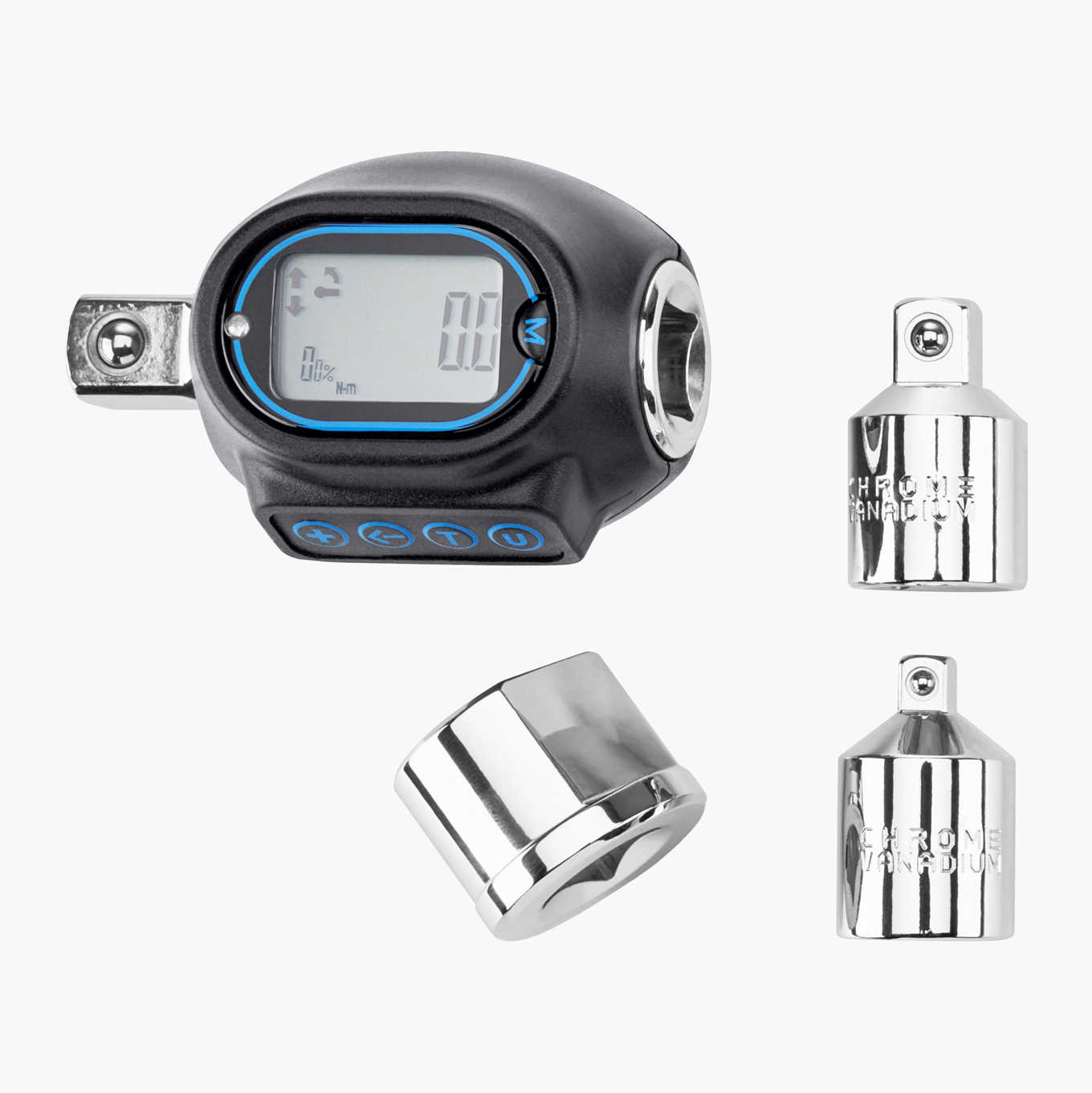

I have a traditional type and a digital device (new).
When comparing, the old manual one is still quite accurate (assuming the new one is) but the digital has the benefit of fitting all sorts of other tools.
The digital thingy was some £ 40
Note: Cleanliness of thread and washers affect the actual torque in any case
