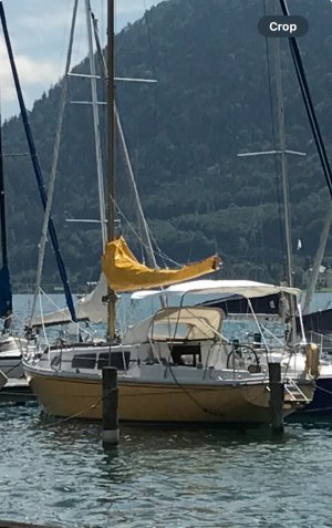

Built in Spain . Mine is from 1974.
I own one for 12 years .
Attersee in Austria ( lake 25 km long , 5 km wide ) can have serious storms ./ wind due to the mountains next to it ….
Super stable boat . Best interior design . Really big front berth . Big single berth . Fixed table / banks can be lowered to another big bed . + another side berth .
Hydraulic steering .
Big water tank
All real wood inside
Big outside area
Sits 6 plus 2 behind the big steering .
Removable table in the middle .
Medium wind 5 knots just with the fock
I paid 25.000 euros for it 12 years ago. Worth every penny
Still has the original fridge working .
No shower . The bathroom ( sink/ toilet ) is a walk trough to the front berth . It can be closed with doors from both sides.
25 hp, two cylinder Volvo penta
Uses very little diesel ( was rebuilt a while ago) and pushes the boat easily.
I heard that they even crossed the Antlantic in this model

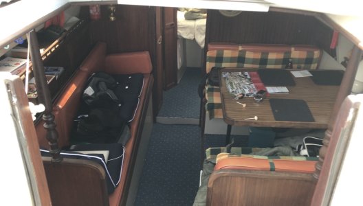

I just love the big exterior with no mast crossing through the middle of the cabin . Fixed table which sits 4-6 people on the side .
Nothing to convert if you sleep 6 people really comfortably
Sails well . Not slow . Lots of storage !
I looked at so manny other boats the past years and could afford a lot of boats but I am just so happy with it ( space inside / outside , just so solid …)
I don’t know how it would behave with big waves at sea…
I try to find some pics
Great condition after 50 years.

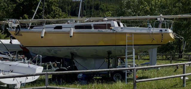

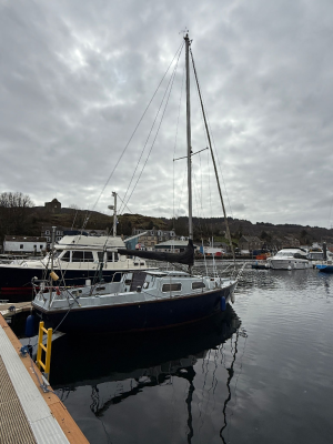

I THINK that's a different boat, consistent with the different name, and the different hull.
The "Lonely Boats" one advertised in Tarbert Loch Fyne is no longer available, and looked like this.
It has the plate design Frank Butler , 9,2 m length etc inside . I will try to find a pic .Maybe they did not build 2 the same or a custom build or an evolution . I think they did not build too manny. I find it interesting that the name tornado was actually used on similar boats while mine is a TORONADO. I always thought people just misspelled it.
Probably like the Pandoras Leisures and Hunters - a bit bigger each year or restyled to the latest fashion by adapting the same basic mould. The Martinlotus one looks a bit newer style than the Loch Fyne one - like the original Pandora to the International - also of 1974.
