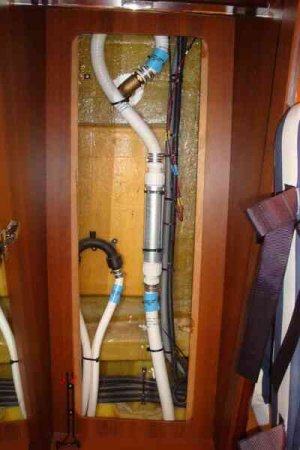

There’s really only two places where a filter setup can be accessible.....in a service locker in the bathroom and above the black water tank under the hatch. Of course, being Beneteau it could be somewhere that needs disassembly of the boat.... I don’t recall seeing it to be honest....but I’m going to the boat today for a look see

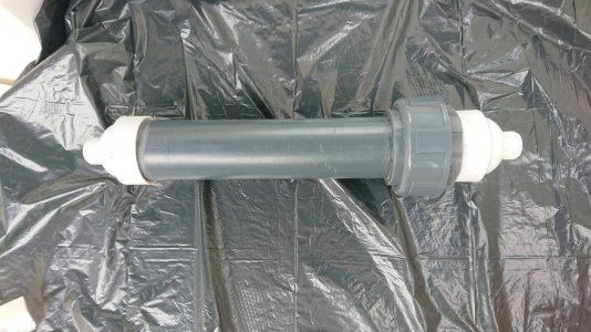

I modified my old cartridge so that it could be refilled with charcoal pellets every other season for pennies instead of paying out £££ to dometic for a new one

Ok…I’m on the boat and have checked everything that a reasonably sized person with double joints could access…and I can’t see one.
There is room on top of the tank to install an inline filter. I could make one, buy one retail or online….any with a one inch fitting on each end will suffice
Be careful to install it in the breather and not in the pimp out line.
Ok…just ordered the filter…should arrive next week…€42.90
For that price it is not worth making my own
