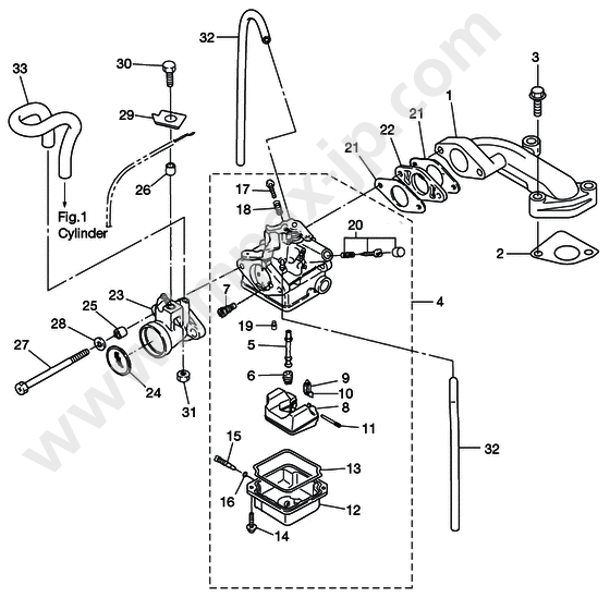

It seems idling revolves around the main jet tube (no 9 in diagram) and air flow (pilot screw). Diagram for: INTAKE MANIFOLD & CARBURETOR for TOHATSU MFS3.5B (3.5 hp) outboard motor

The idle mixture screw (#20 below) may be hidden under a plug

BTW is the rubber cap, #19 in the diagram I posted , in position. I dont know what it is but it would be as well to check its there
True. Once it is running you can weaken or richen it to suit.
I don't know about the rubber cap but did come across mention of it a blog in which the owner replaced it after having it loose in the float chamber. It stopped the carb tending to flood, apparently.
