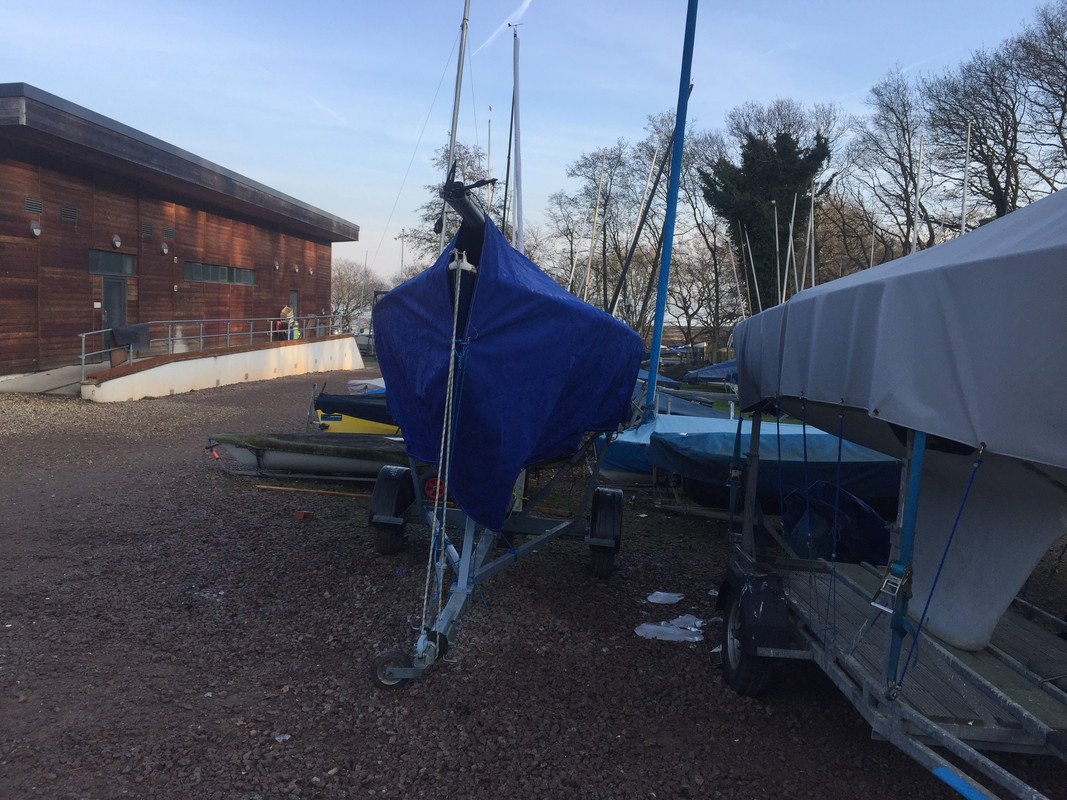

Sometimes nature cover for me
Does this count as a cover?
