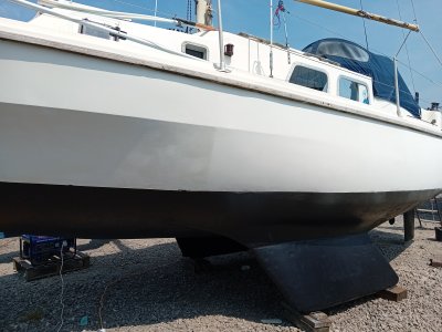

I'm thinking of applying a bright red boot top TAPE over the not-very-impressive join of my white topsides and newly-painted black antifoul. Any advice?
