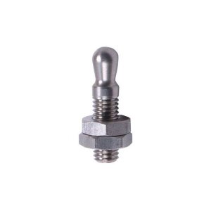

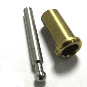

18 years down the line but I feel the need to correct this statement as it made me buy the wrong thing & I'm guessing people are still installing Simrad & Raymarine kit. The Simrad tiller pin has a "shoulder" which locks nicely to the Simrad socket - I can turn the thing upside-down & it stays in place, which I like. The Autohelm/Raymarine has "sloping shoulders" & the pin pops out unless held in place. A bit of elastic or amalgamating tape may solve this but I prefer the click-fit of the Simrad original. However the brass socket at the other end does seem to be identical on both. It is entirely possible that the Raymarine pin is also gripped better by the Simrad sharp-shouldered socket but I don't have one to test.
