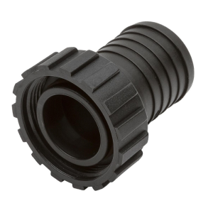

I assume the filler fitting is the item illustrated in the attached picture ( or the angled version of it)
It should seal on the joint washer. If the threaded collar is a separate component, sealing the thread will have no benefits.
Do not overtighten.
As far as the fitting for the vent is concerned if it is a tapered fitting it should seal on the thread . If necessary the Tru Blu thread sealant suggested by footsoldier would be suitable.
If the fitting has a parallel thread it should tighten with a shoulder on to a joint washer

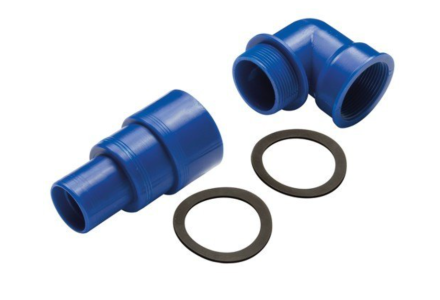

Thanks for your help.. See picture below. I'm not using the 90 bend. Just connecting the stepped fitting straight to the tank. I want to get it right as it would be really awkward to get to in the future. The other fitting is a 1/4" BSP tapered thread for the tank breather. Would PTFE on the thread be OK or will the diesel have a detrimental affect on the PTFE?
As a side note, I emailed the manufacturer, and their only comment was to use a generic sealant.

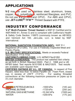

I have always used JetLube V-2 Plus for things like this.. The spec sheet says its good for polyethylene (polythene) fittings and for diesel up to 145psi. ( as well as for potable water and even gas)...
It's non setting and very easy to work with..
Data sheet at the link below...
https://docs.jetlube.com/documents/...+PDF/English/Jet-Lube/V2+Plus_TDS_English.pdf
I don't know why others never seem to suggest it.. but if there are reasons not to use it then let me know.
