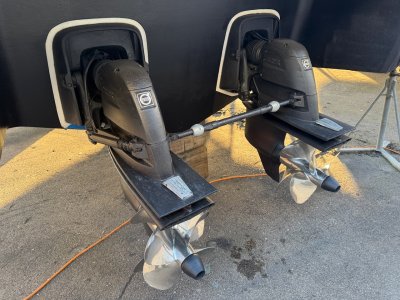

To provide a bit of balance, these are the outdrives on my 15 year old boat.
In a few days time, I might even be able to stand up straight and walk normally.
Antifoul splodges were rubbed off the anodes and blue tape removed after the picture was taken.
The steering ram in the water design by Volvo, who were very experienced in building out drives, was particularly stupid.
Then their refusal to support people that suffered repeated failures from this indisputable design flaw was typical too.
Yet Volvo engines boats tend to sell more easily.
Go figure.
SC35
13 Jul 2021
2,731
Go figure.
The steering rams on mine lasted 12 years, which isn't too bad.
Go figure.
This is absolutely true. Unlike the trim rams, which you can protect by leaving the boat trimmed right down thus making sure that the shiny extending part of the ram is fully retracted inside the larger section, with the steering rams if you turn one way retracting the ram, you extend the one on the other side! The shiny parts would get crustacea growing on them and as soon as you started steering, the abrasion of the growth sliding in and out of the main part of the ram would wreck the seals which would start leaking. It was an absurd situation.
Volvo Penta fixed it eventually by putting little rubber bellows over them to stop the growth (you can see them on the steering rams in SC35's photo above), but a poor design initially and definitely not Volvo Penta's finest hour!
I always cringe when I see outdrives on boats on deepwater moorings like marinas left with the legs trimmed all the way up to the beaching position because they're inviting the above problem with the trim rams (and it can't be good for the bellows). I guess it's people who previously owned outboard engined boats where it's sensible to leave the outboard trimmed right up because it's then all clear of the water (not the case with outdrives).

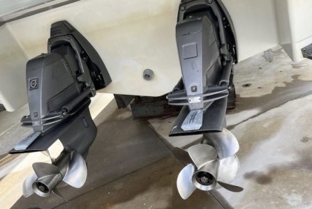

The ones on my new toy. Been pretty well maintained by the previous owner ( well, actually the service company he used) . The surveyor noted a few places where the antifoul needs touched up as an advisory but otherwise they were 'bieng!'
I must admit I was a bit nervous about buying a boat with sterndrives but the surveyor agreed with the opinion I'd got from many people - they need more maintenance but provided you allow for that, they have many advantages. Looking forward to taking her out for real.
There is a major advantage to having the external steering rams, which is that the steering is more precise compared to my previous DP-E’s.
They had the option to change things on DP-I, but they chose to stick with it.
The latest rams do last longer - it was the initial batch that failed very early.
Yes agree entirely. The basic idea was sound, just initially poorly executed (but now sorted). :)
