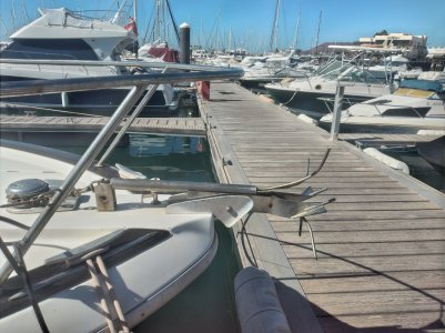

The perfect anchor, a gift.
Perfect anchors if you wish to stop and fish for a bit in a small boat. Also diving from something like a rhib. Easy to recover and stow.
Local fishermen also make grappletype anchours out of rebar
Common place, or varients, in Australia over coral reefs or rocky anchorages like Tasmania. Depends on the size of the rebar (some are made from 'sort of' glorified wire) - but with out much effort they will straighten, and simply pull out without damaging (much) the coral and no damage to rocks. In Korea they are really upmarket and weld 'flukes' to the ends and make 4 fluked fishermen's style - and can be large - 'man' sized.
They are supplied in Oz as a straight item, 4 pieces of wire, which you bend to shape when you use them. They tend to be small and focussed at the small run-about fisherman market. Being 4 pieces of straight wire they are easy to store.
If you need to abandon - they are hardly expensive.
I confess, I've never used one. I'm nervous being close to either coral or rocks :).
However - as so many commercial fishermen use such devices, based on rebar or wire, with or without welded flukes, and are common place on the bows of local Asian boats - they must work - to a greater or lesser extent.

IIRC If well dug in, you can unfold just two flukes so there are not two sticking up in the air to catch people or hulls out...

It also occurs to me the Grapnel is going to attract sand and mud like nothing else, all those nooks and crannies. A pet hate of mine.
My heart says cable tie the flukes and use it as an angel so I smile every time I use it. My head says hang it in the shed, freecycle or bin.
That small bugel looks purpose made to go through the bottom of an inflatable. Quite cool for a rigid dinghy.
