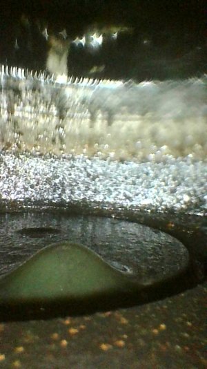

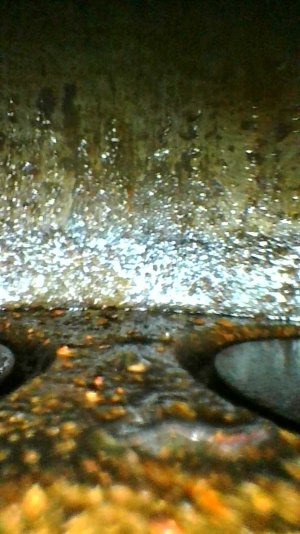

I took the boat from it's previous mooring to Port Vauban and happily used it for about 2 months until 1 day it literally took 10 seconds to start!!!! I checked obvious things like the fuel and yes it was not in great condition, so I changed filters and still the issue was there. We were at anchor overnight and the next morning the engine refused to start. I tried several times and eventually it made a hideous bang and smoke came from the inlet, lots of it.
So at this point I had a Cummins specialist come down to take a look and it was diagnosed that at least one injector was faulty and they were removed and a camera down the bore. Oh dear

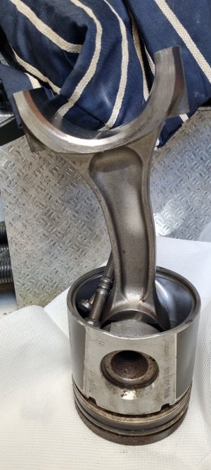

Effectively the engine had ingested seawater past the o-rings in the Aftercooler that were fitted by the company that had charged €35,000 for the service about 20 hours prior to the failure and more than 16 months ago, so no point approaching them for a warranty.....
The damage was a head rebuild, that was done twice due to the French engineering company leaving water in the head and fitting the valves incorrectly. The turbo rebuilt, the aftercooler rebuilt and a bag full of parts.
Basically new pistons, liners, conrods, bearings and all of the gaskets required to rebuild.
So the rebuild started having removed the 1 bent conrod initially and then the rest of the pistons / liners.
The rebuild took approximately 5 days to complete, the engine has now completed 35 hours of running and all the oil samples are good, which is a relief. The final bill was around €20,000 including around €6,000 in labour / flights etc and approx €14,000 in parts.
So the morale of the story for me is take a bloody good look down the aftercooler pipes to see if it is clean. I've never done that before and accepted that it had been serviced only 7 hours prior as a thumbs up. It's been a tough lesson, but fortunately not to expensive, especially if I had accepted the quote from the companies in the area.
