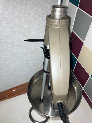

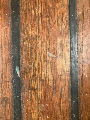

I found Termite Frazz, in my fwd heads ! Other Times, it had been easy to deal with ! This time it was in a very ! difficult place in my fwd heads ! However , the fwd. head, is a very small room ! So , I emptied everything ! At the local Ironmongers, I paid. 8 euros, for an. outdoor .. indoor. digital thermometer cost. 8 Euros ! So , I taped the outdoor sensor, to the underside of my toilet box , then using my heat gun, I heated the underside of the toilet bench , to 69 deg C for 5 hours ! That did the job !
