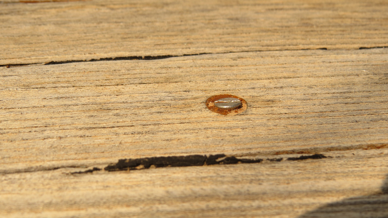

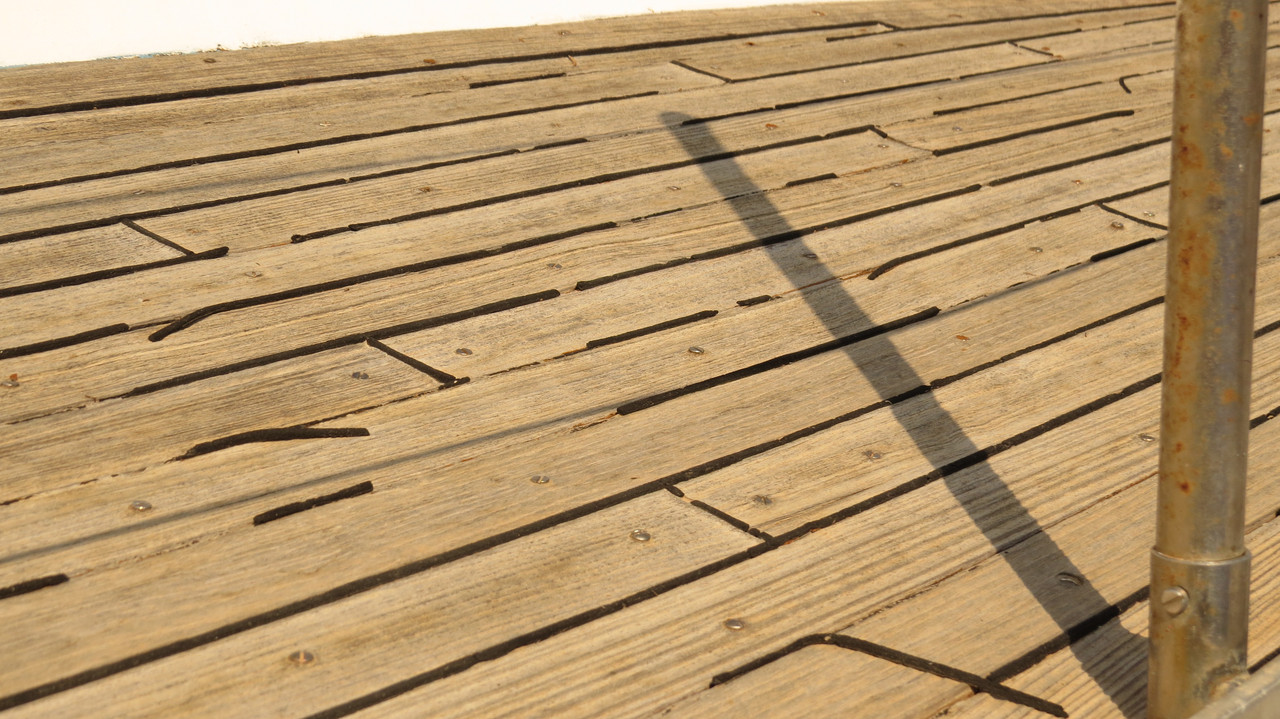

This is not ours but shows quite clearly what happens with no treatment.
Well it takes some trick to keep that colour, I reckon.
In absence of any treatment, just some weeks after a sanding, the surface is bound to turn greyish.
And that surface is pretty far from looking freshly sanded...

I doubt if it had been sanded for years. The boat was next to us in a yard in Aegina. Whatever colour you think you are seeing is a function of the sunlight, not treatment.
Agreed, it takes a while for the sunlight to turn untreated and unvarnished teak into its typical greyish colour.
When I said "some weeks", I had my Sardinian-based experience in mind.
But it if the teak in your pic didn't turn grey for years in Greece, I can only imagine that it must have been kept well covered practically all the time.

There is always the possibility that it is not teak at all but some other timber. Certainly was a rough old job.
Hard to tell just from a pic, but it does look teak to me.
Also the colour is actually right, if it weren't that over time it turns grey when left untreated.
But when freshly sanded or cut, that's indeed the natural teak colour.
Regardless, the builder should be ashamed of that job.
On top of being awful now that the screws are exposed, they also made the GRP deck underneath akin to Swiss cheese.
And if it has a sandwich construction (as is usually the case), more than likely it's completely soaked by now.
Unless the whole boat was kept sheltered/covered of course, which might explain also the fact that the teak didn't turn grey.
Good luck to the owner.
It's going to be a helluva job in any case, either for fitting new teak or just removing it and re-glassing the surface.
Except of the gold colour and the ruined caulking (a sign I guess of unsuccessful attempts to protect/maintain the teak), the condition of this deck is unfortunately a very typical example of teak left for some years and without any proper protection under the hot Med sun.
The use of screws is another story. Used I am afraid by many boat builders. On my last boat I had to replace the teak in the cockpit because of the exposed screws.
