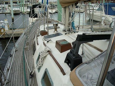

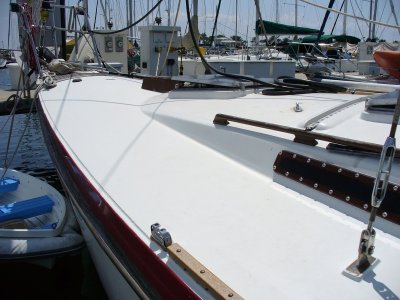

I removed teak decking on my boat (English not Swedish) and replaced with paint. Happy with the result but it could devalue some models.

In my last marina, I watched my neighbour remove the teack deck on his HR41 ... there were hundreds of screw holes in the deck which needed filling and sanding. He replaced with textured paint and the boat now looks fantastic, but isn't "original" any more.
If you can live with it, textured fiberglass is the best deck material IMO. Cleaned with oxalic acid and rinsed off, then sealed with a good wax polish. HR did produce boats without teak decks but they are hard to find.
