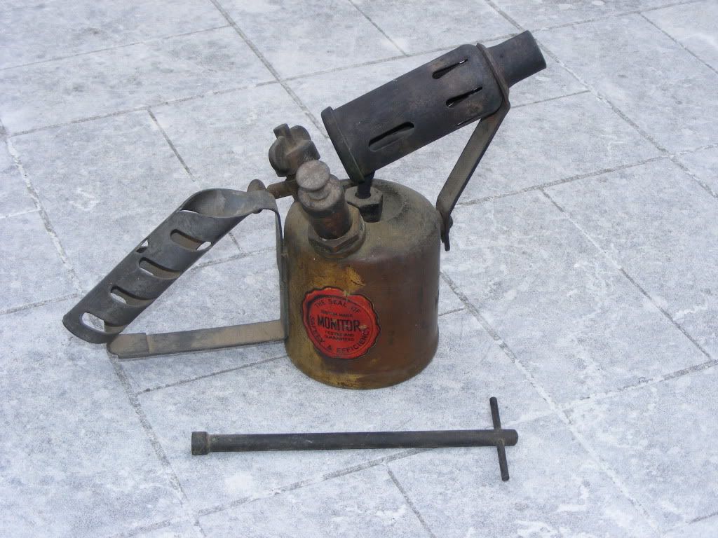

There is an alternative to the gas blowlamp- just use a paraffin blowlamp. This just needs paraffin and a small amount of meths and avoids carrying gas.
blowlamp anyone?
Pressure paraffin stoves anyone?
The first time I saw someone use a fast-start blowtorch my eyes popped open wide. Having nongimballed (optimus) installation, I had to wrap asbestos type wick around the preheat bowl but it worked reliably.
I believe there is a Optimus model that uses low pressure paraffin for the preheat and you pressurise the main tank as it preheats? Tedious tho each time.
