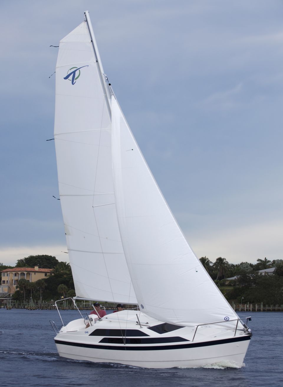

The photo of it sailing on the top posting is a nice clever piece of marketing photography. Taken from the lee bow, she is moderately heeled, to disguise the height of the topsides, nice crisp new sails setting tolerably well, and you can't see the really ugly transom and engine. At a glance it looks not bad at all.
On second glance look at the curve of the luff foil on the jib, the minicar-sized wheel, and note how flat the water is, then go to the website and look at the truly horrible stern. Now if you cut a hole and put a well in the forward part of the cockpit to put that 60 hp engine in, nice drinks table on top, prettier stern with a tiller ....... but the marketing people are selling to US car-drivers.

I worked on and off for a Mac Importer some years ago and unless the build quality has dramatically improved, I wouldn't want to take one around the top of Scotland. The sagging forestay is probably a reflection of the overall stiffness of the structure, if past Macs are anything to go by; tighten it and it'll pop out of the deck.....
