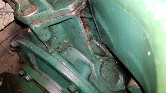

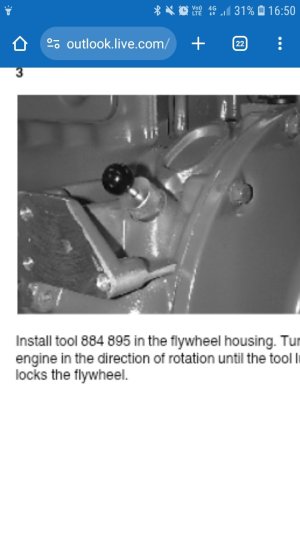

Hi folks. I can't for the life of me find the hole for the flywheel locking pin on my 41A. It's not in the location shown in the manual and i cant see anything obvious anywhere else. Anyone got any pointers?

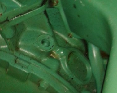

I've added the similar view of my engine alongside yours for comparison. If you remove that oval plastic cap, does the hole in the flywheel exist?
