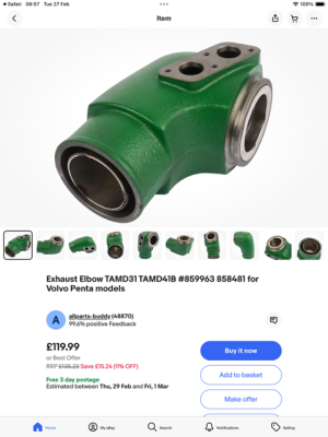

All very interesting. I have conducted a little experiment and ordered some other non OEM elbows from a couple of the bigger outlets so I can compare. I too wouldn't be surprised if they are all the same unit. It will cost me a few quid in postage but my curiosity has got the better of me.

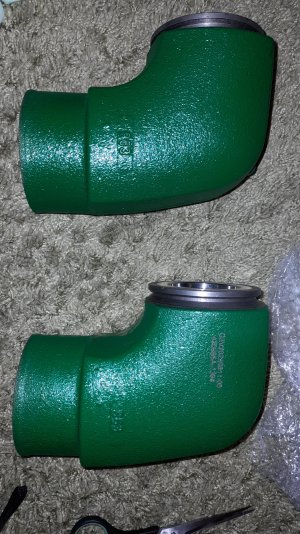

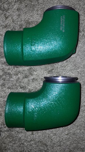

Looks good. Does it have the water outlet?
Doesn't sadly, elbow only. I plan to reuse the flanges/pipe and just renew the gaskets. That being said, none of them did.
The second half of my experiment arrived today. Same scenario as yesterday, identical, right down to the number cast on the side, except this one cost north of £300 quid.
Conclusion: I am more than happy to put my ebay elbows on. If you are reassured by greater price tags 'other' elbows are available! However, the ebay elbows are NOT stainess steel as advertised. I will raise this issue with ebay as it would have been a waste of time ordering if I wasnt happy to go with standard cast iron.
