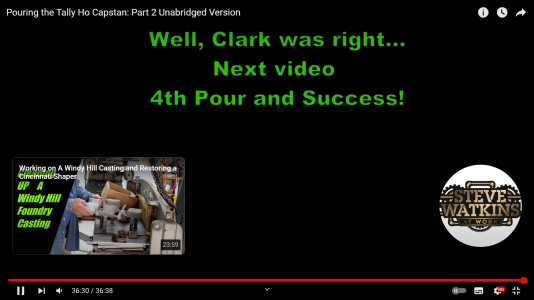

I have not followed it and may be missing something but this is a still from the end of a video posted two days ago:

Well they got the pour OK waiting to see how it comes out when they break down the mould and then how it cleans up. Hopefully no inclusions this time, it's one hell of a job.
