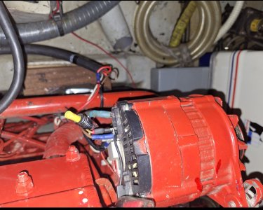

Comes from the back of the alternator. Mine has two (which is why I missed the broken brown/yellow one). The second one goes to a separate smart voltage regulator. Yours may only have the brown/yellow.
Minerva's comments are good. Check everything before dismantling etc.

Thanks for taking the pic, really helpful I’m going to crawl in and have a good look,

Engine running battery only 12.6. Removed alternator, my wiring looks different to yours. From plug 2 x brown to busbar connecting to battery plus brown/ black to loom. Black earth from ring terminal( removed with blue tape on post) no other wires.

There are wiring schematics in the Beta Installation and Operators Manual which may help you. There are differences between the alternative alternators which may be fitted.
