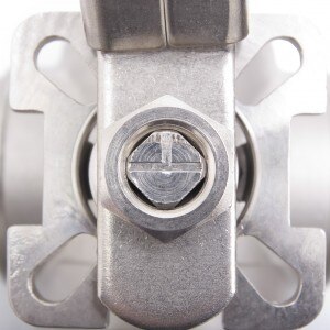

On the 3 way valves I have if you remove the handle there is an indication on the end of the square shaft as to the type and orientation of the valve inside
This is the valves I have and you need to remove the handle to see the markings
