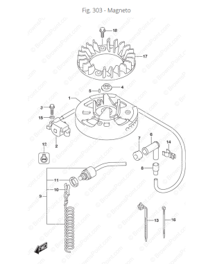

Electrical system looks pretty simple.
Are you sure you have no spark?
Spark plug removed and end on block while turning over would confirm.
Kill cord switch okay?

Ill check with my mate about the kill cord, he could definitely have forgotten that.
The rest will be down to me.
I have an in line spark checker.
I will look up CDI costs as well.
