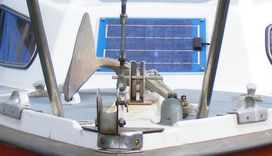

My boat is a Sea Wych very similar in many respects and from the same era. I built mine from a kit
It sounds as though your foredeck is like mine with a imitation king plank down the middle. Reinforced according to the original brochure
It does have a chain bollard about half way down. (See picture) I am pretty sure the Sunstar I know has something similar.
You can also see the chain pipe.
(A hawse pipe is the pipe through which the hawser or chain passes in the side or bulwark of a ship.
A more correct name therefore may be a spurling pipe or navel pipe. The pipe through which the chain passes on its way to the chain locker. Alternatively perhaps simply a chain pipe.)
My stem head fitting is bolted through the same raised section but I put a block of hardwood on the inside as well so I know that's well reinforced.
