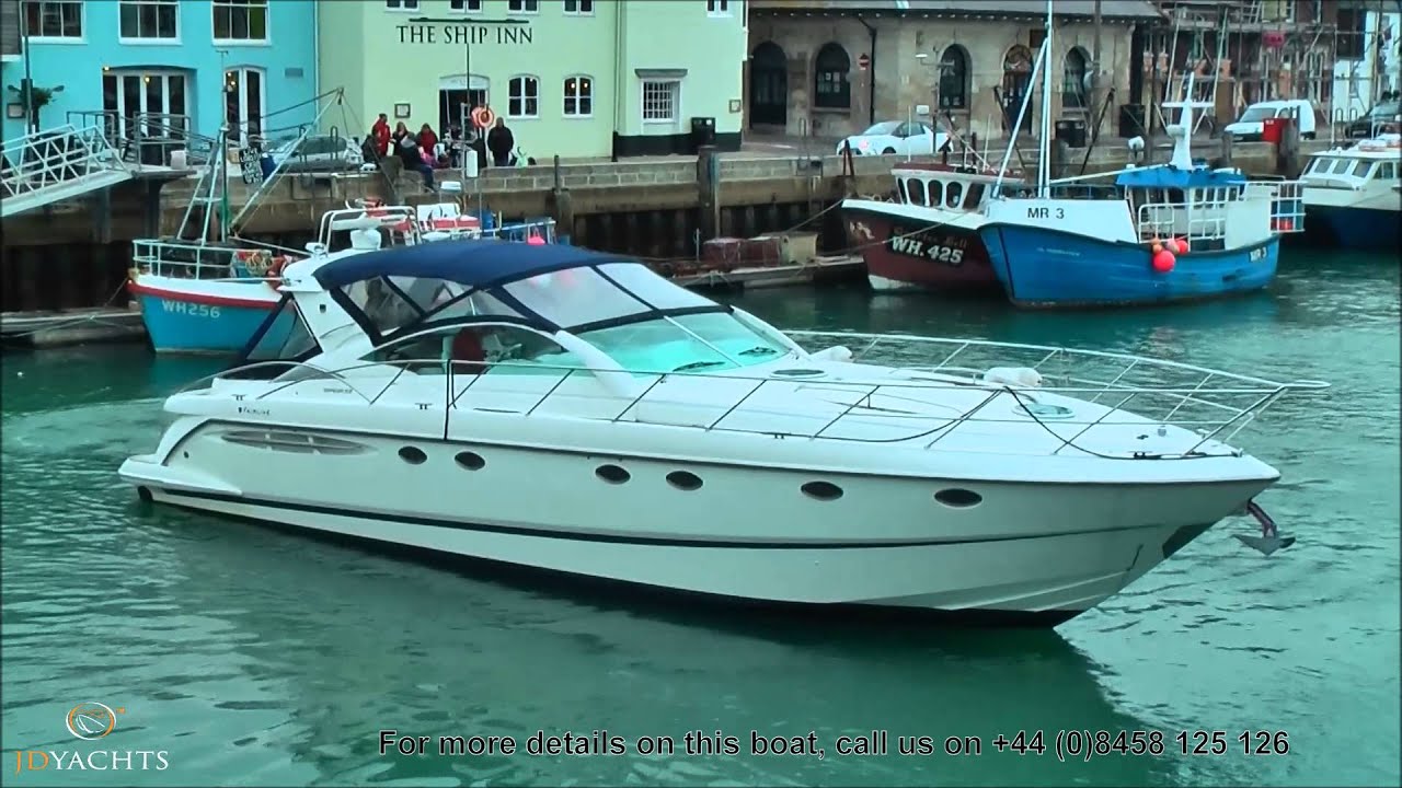

One more thing that I remember from the Sunseeker - the rails don't run far enough back towards the the stern, so you're very exposed when moving from the cockpit to the side decks. T52 is much better in this respect.
Thank you very much for your input. I do remember that the std rails on the T52 are also somewhat short aft
Hmm, I'm not sure I agree. I've only been on maybe three or four T52s, but I do remember the rails coming back far enough to allow safe manoeuvring from the cockpit to the side decks, and on the Portofino I noticed that this was a lot more exposed. The T52 did have a few significant revisions through its production life though, so maybe this was different with the early ones, I don't know for sure. (Petem, got anything to add on this?)
Looking at the web, it does appear that some (early) T52's have an extra rail aft.
See:
Later ones don't seem to have this extra rail. I guess it also depends if you're happy to swing round and climb over the sunpad or if you want to go down the step to the bathing platform.
