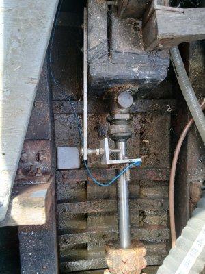

When the circular cover is unscrewed the reservoir appears to
be full of grease and it also contains a large nipple, is grease meant to
be introduced under pressure or is the pressure from screwing the
cover back sufficient ?

The big nut at the end is to adjust the pressure on the packing. If you google "adjusting stern glands" you will find plenty of information. The detail designs vary but the principles are the same. Your is one of the more common designs.

The cap of the Stauffer greaser has to be filled with grease and then as you screw it down grease is forced into the bearing.
To help your back, you might consider fitting a remote greaser.

These jobs are awkward due to where the stern gland obviously has to be fitted. We have a 38' Buchanan and it has a remote greaser as did our 28' Honeybee. The stern gland is supposed to drip when under steam (about once per second IIRC) so there will not be dry bilges. We would put a slight turn on the greaser when we remembered after a passage. You can site this somewhere convenient that doesn't require a monkey to get at. The bit nut at the end keeps everything where it should be and if it comes off you will tend to leak significantly more than you want!

As far as I can see, looking at the photo on my mobile's tiny screen, the lock nut isn't doing anything. It should be tightened up against the gland nut to prevent the latter from turning.

It's getting better, that is my limited grasp on things,there is a very slight drip from the greaser when I took
the cap off, that appears to be all from that part, thanks to another reply I will ,this weekend, make sure
the locking nuts are tight and doing there job.
