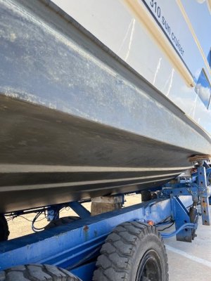

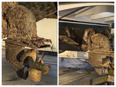

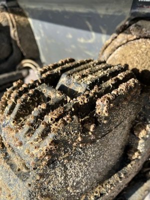

I have just lifted my (new this season) Marex with Mercruiser engines and stern drives for winter storage. The boat has been in water from mid April and the hull is clean as a whistle but the stern drives are horrid!
All will be cleaned tomorrow but my problem is that Mercury warranty is invalidated if any form of anti foul is used on stern drives (at least as far as the casing is concerned) and I am obviously keen to avoid that problem.
I can at least put something on the props without this problem…propspeed?
It maybe I have no choice but to make sure everything is cleaned properly at the end of each season until warranty expired but am interested to know what anyone else with stern drives has experienced and if there is a ‘magic potion’ I could consider.

Yes, I have the same problem. 6 months in the water and it looks like this. The Hempel Hard Racing does a pretty good job on the bottom but the drive and tabs after 6 months in the water look like this. The back of the boat is not so good but I doubt that slows it much. The props were polished to 'as new' last winter and I sprayed the drive with Hempel Ecopower. Useless, a waste of money.
I think most of the lost performance is due to the dirty props since much of the growth on the drive is above the bottom of the boat where there is not much water flow.
Even after jet washing there are lots of tubeworms and shells and I push them off one by one with a plastic or wooden scrapper. I am hoping someone will have a good suggestion. It's too far down for a bag to be practical.
It's a VP drive on a Sargo.
