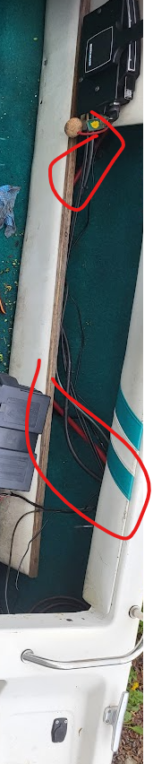

I always thought the original cable was too long and it snaked heavily down the side of the boat. Fig 1

Fig 1 - Cable was snaking heavily down the side of the boat,

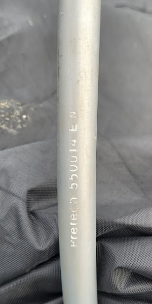

Cables side by side - Red is the old one
Original R&P
Pretech 5500 14 en - New
3000 STEERFLEX STEERING SYSTEM 9ft
Original R&P
