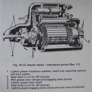

Very lightly oil I said but that is in the very unlikely event that it is an inertia type
There are numerous points to lubricate in a pre-engage type

I know VicS post shows page saying grease ... but I'm not a fan of grease except in stern seals .. on other - grease can end up holding salt etc ... so I prefer a reasonable oil periodically ... which tends not to hold salt / crud etc.
But that's me ...

The problem is that you have to remove the starter and dismantle it to lubricate it. Not something most of us would want to do on a regular basis.
