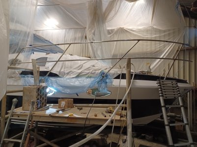

Starboard rails assembled and tacked together.
PCUK
29 Jun 2005
8,504
Westleigh, Nr Tiverton, Devon.
Just got to copy them on the port side!
If the rails look slightly deformed that's the lighting and the stanchions look as if they are all over the place but they are all the same angle, it's just as they follow the curve of the deck that they look out of alignment from beam on.
This is an interesting project with many angles to deal with including the notching out of the tubes for welding but I've only ruined one 40 inch length of tube so far. Hopefully the port side will be plain sailing.

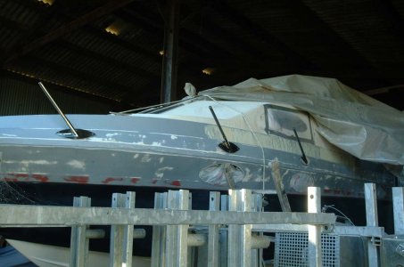

My rails have been assembled on spigots bolted to the outside surfaces to maximise deck area. Once the port side is complete I will lift off each side individually and complete the welding, fairing and polishing on the bench.
The spigots were fabricated a few years ago before I started the paintwork but you get the idea.
