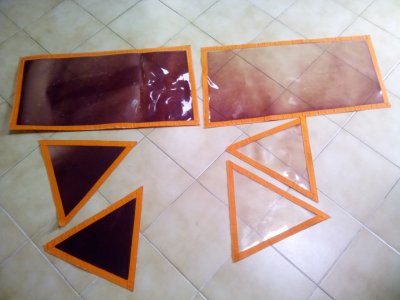

As you say, double-triple check what you are buying is really UV resistant, these were my windows after 2-3 seasons of intermittent use, the darker ones were exposed south; PVC was bought as "UV resistant" from a local chandler... :(
The windows on an old sprayhood went opaque. I was surprised as it was not very old.
