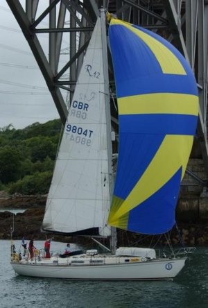

My boat is also a cutter, 42 not 46' long but fairly heavy nonetheless, and we have a spinnaker. The pole is asymmetric, and the mast end is not detachable (ie not without without spanners etc). We use the spinnaker quite a bit - one time during the 3-peaks race we gybed 19 times while transiting the Menai straits, and that at LW springs!
Our technique depends on wind strength, crew size and experience and whether we're cruising or racing:
Easy method is the snuff the spinnaker and then detach and reattach the pole the other side of the forestay and un-snuff the sail on the new tack. It's invariably what we do when cruising two-up as a couple.
Harder but quicker is keep the spinnaker flying:
1. detach the pole from the guy (having set the uphaul such that it will only drop 6" or so)
2. lower the up-haul while the mast person raises the inboard end of the pole enough that it can be passed across inside the inner forestay
3. adjust to steer dead downwind and adjust sheets so that the spinnaker is flying from the two sheets, with the guys slack
4. clip what will be the guy into the jaw of the pole
5. lower the pole at the mast end and tighten the uphaul to get the pole at the right height
6. adjust sheets and the active guy while the helmsman steers onto the new gybe.
Sometime between 3 and 5, gybe the main.
With practice and 3 or 4 fit people it can be done in 60 to 90 seconds. You have to rig the spinnaker with sheets and guys, both sides.
Here's us about 8 gybes in (the hard dinghy was a bit of a pita during the gybes, but saved our bacon when we had to tow in flat calms).
