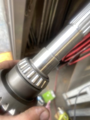

Looks like you will have to measure yours. Its quite easy with a vernier caliper.

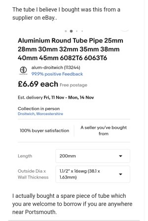

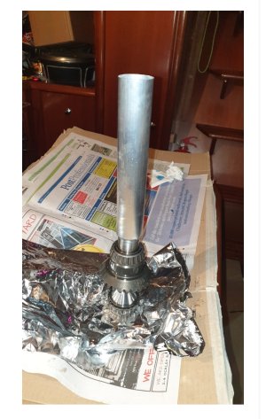

The speedi sleeve comes with a collar which is used to drive the sleeve when tapping it with a mallet into position. This collar was much too short so i needed to find a suitable diameter tube to drive the collar and sleeve home.

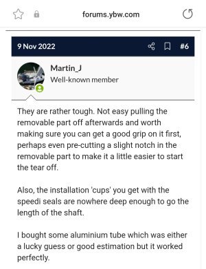

And as Halo mentions, you will need a longer installation tube in order to fit them to the shaft, since the provided closed end tube is way too short.
The following screenshots from a previous thread might help with the size of tube needed...

I went to a local DIY store and found the ground anchor for a rotating washing line was just the right size and length when I did mine.

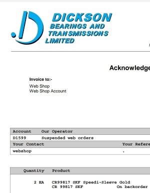

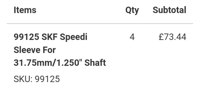

This is what I ordered for my 120 S in 2022. Still doing its job 3 years on.
