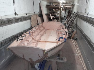

Hi BB - I've just looked at a wooden Mirror mast - it's only 2" diameter. The mast for my pram build (Woodenboat Nutshell 9' 6") has to be 2 3/4" diameter. The mast for this dinghy is unstayed hence the thicker diameter I assume.
DownWest
25 Dec 2007
13,834
S.W. France
Aquaintance built the shorter version as his tender. Very useful little boat.
My comment earlier about the birdsmouth system, it produces a light stiff spar, even if using slightly heavier wood. On my 15ft faering, the mast, yard and boom were all made this way. Sounds complicated, but actually quite fun, even if I had a deadline to finish. You need a bench saw and/or a router, but possible in your container(?).

Thanks for the replies. Have plenty of Douglas Fir, several routers + JessEm router table with lift, but not sure what the birdsmouth system is. Also built the smaller version, about 89/90 but from Jewson's so called marine ply.... Cut that one up a few years ago. It was a superb towing tender.
