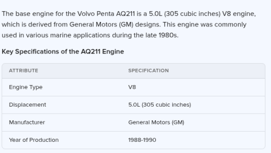

Funny thing, when you used to ask Google a simple question like, 'what is the base engine used for the AQ211' you used to get an answer !
Now you don't, AI at its best ? So what is the base engine for a AQ211 please ?

I found the information below - hope it helps . Whether its correct or not I have no idea .

You Have asked the same question on another thread to which I gave much the same answer as Momac
It is confusing to ask the same question in two different places.
