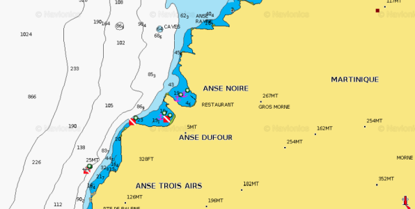

We have just spent 2 days swimming with turtles in Anse Dufour.
