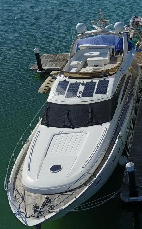

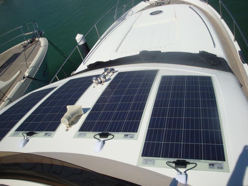

Here is my installation

We installed this system earlier this year and it was a huge success last summer.
If you get time, there is a full write up on this system in the December copy of Motorboat and Yachting.
